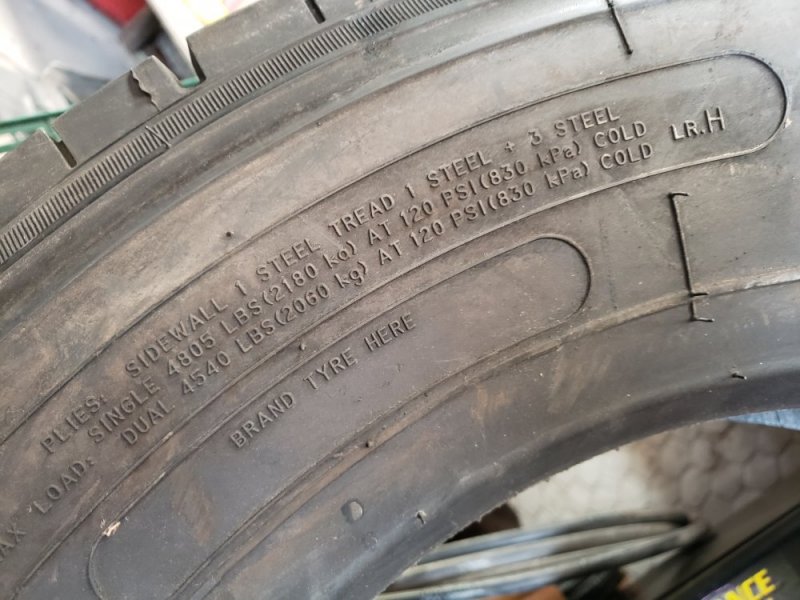

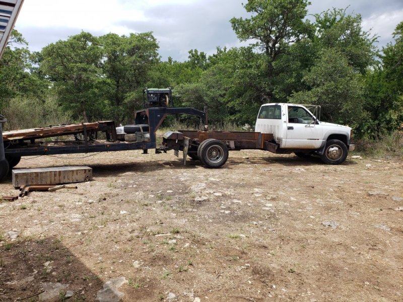

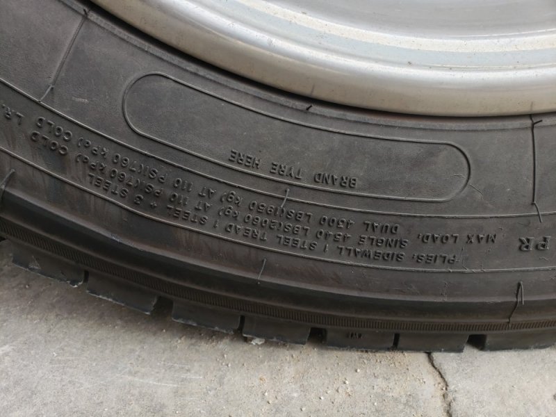

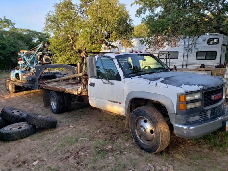

They are factory on the 3500HD's from the 90's, stock size is 225/70/19.5 but I'm running 245/70/19.5"s (true 33"). Each tire has a load rating about 4,000 lbs and when not towing I'm at 65psi which is about the lowest to go with a safe reputation at lighter weights. Common lighter duty tire places such as Discount Tire do carry and will work on 19.5"s in my experience with their common sizes (225/70 and 245/70). Some of the lightest weight rating tires I've found are a load range F and the tires on my truck are some of the more offroad aggressive tread patterns.
Towing it's a nice upgrade in stability and never having the tires near their max capacity. Long life span, even the cheap tires have a 50k+ lifespan usually, quality ones can be around double that. Harder to puncture the tire (I've run over quite a few cactus plants, one of the 235/75/16"s on the old dually got a flat from those same spines). Very stable on the road. Using balancing beads in mine with good results.
Downsides in my experience, rougher ride, higher up front cost but cheaper in the long run, and initial break in. 19.5 tires are well documented to be slick in light rain conditions for the first few thousand miles. Offroad traction isn't as good because they can't be aired down enough to flex and the sidewalls are not capable of even doing that.
My opinion, if the truck is mostly on pavement and hauling heavy weight often then 19.5"s make sense. If more of a general purpose rig, non commercial sizes like 16"s are a better fit. The more aggressive 19.5"s like mine will handle dirt roads/minor trails fine but only as good as a decent A/T tire at full pressure.

Realized after your reply that I had a typo in mine hahaha. 4 of my tires are G, the 2 new one's are H.
The H tires are installed up front and the 4 G rated tires are on the rear. F's would be better for my use but haven't found any with that weight rating in the 245/70/19.5 size. Rear axle in the HD's is rated for 11k pounds.
