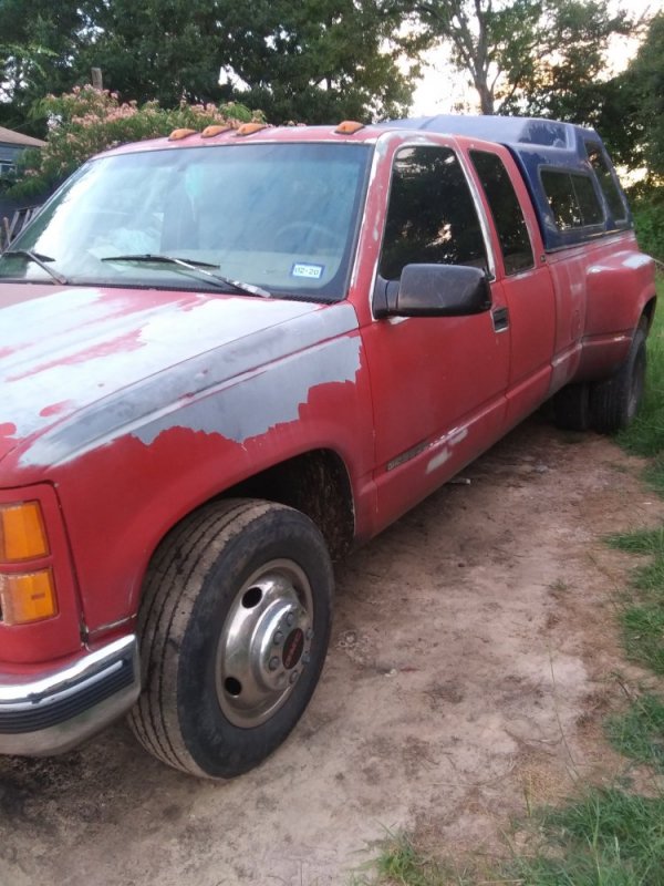

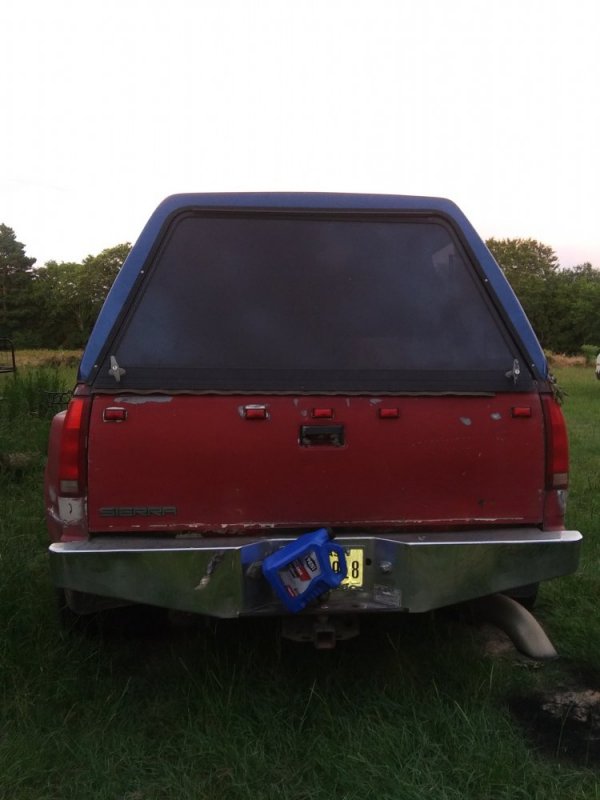

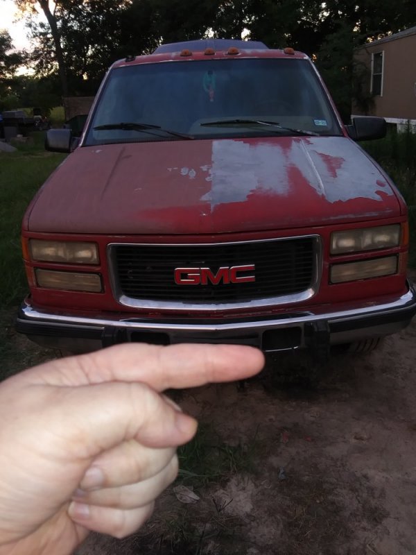

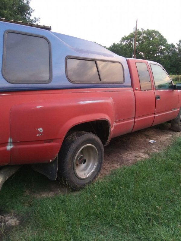

GMC Sierra 3500. Chrome is good... Exterior just needs a paint job. In Texas so very minimal rust. Interior... Drivers seat is shot (big "rip" on door side), backseat good. Dash good. Steering half decent (leaky fluid system but we keep it full). New ignition. Only real problems are whatever is wrong engine wise (not crankshaft, may just be injector pump, injectors, fuel sock in tank... Fuel system overhaul) the glove box has a broken open stop and missing a piece of the outside. And the heat/AC vents passenger side are in need of tlc.
And it's dirty...
And it needs tie-rods drivers side...
