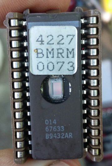

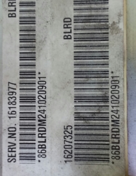

    Havent run codes yet but just replaced both speed sensirs, changed nothing. I was told my prom might be bad? or my computer? how or where do i find these?
  8. crazygspguy2010
    crazygspguy2010 New Member
    14
    0
    Jul 19, 2016
    florida
    These are the numbers but dont know where to get tested or replacement? was told i may need updated prom?

  9. THEFERMANATOR
    THEFERMANATOR FRANKENBURBAN Staff Member Lead Moderator
    8,820
    2,021
    May 9, 2008
    ZEPHYRHILLS FL
    Without codes, you're wasting time/money doing anything. If the wnfine runs fine, then my bet is the prom is fine. There was an updated prom to fix a 1-2 shift issue, but you're describing limp mode. It shouldn't take you more than a m8nute to short the 2 pins with a paper clip, and count the flashes of the check engine light. Until you do this, ANYTHING else you do is a waste of time. Throwing parts at it is doing nothing but wasting your money, and many times I've seen people swap in "new" parts that were bad, and created problems they didn't have to begin with. Electronics are not that hard to work with, but guessing and playing spin the wheel of diagnostics just wastes money.

  12. Will L.
    Will L. Well-Known Member
    6,904
    4,920
    Jan 25, 2013
    DTC 34 - Injection Timing Stepper Motor Fault
    DTC 78 - Turbo Wastegate Solenoid Fault
    DTC 87 - Transmission Gear Ratio Error
    Remove and clean ground wires for ecm/vssb and on engine especially tranny dipstick location. Also main battery cable. This has solved 5% of my electrical problems of the last couple decades.
    Address the 2 engine codes seperatly and FIRST. They can cause it. Transmission and eprom might be fine and they are reacting to engine issues.
    After that:
    You already replaced the output speed sensor, did the old one have shavings on it? Did you use the 0.010" spacer for it? Ohm test the new one- bad new elctrical parts are not uncommon.
    Any damage to the harness to that sensor outside he trans?
    Has the tranny pan recently been removed- if so pull t down- I pinched the inside harness once and had the fight for a year until i found my error- same code.
    Once you go through all that then maybe swap new eprom. If anything is wrong with above a new eprom wont fix it and may add more problems.
