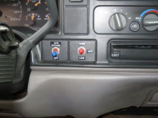

  12. Ill Tell Rusty you said Hi, I relocated the OPS by using a AN 6 x1/4 np 45 about 12 in an6 line and onother adapter back to np1/4 female, I did the relay mod but ran a lead to a switch on the dash so i can overide the OPS to prime or keep me going if it fails
    [​IMG]
    heres the switch on the left the other one is a high idle on that I used a on-off-on switch
