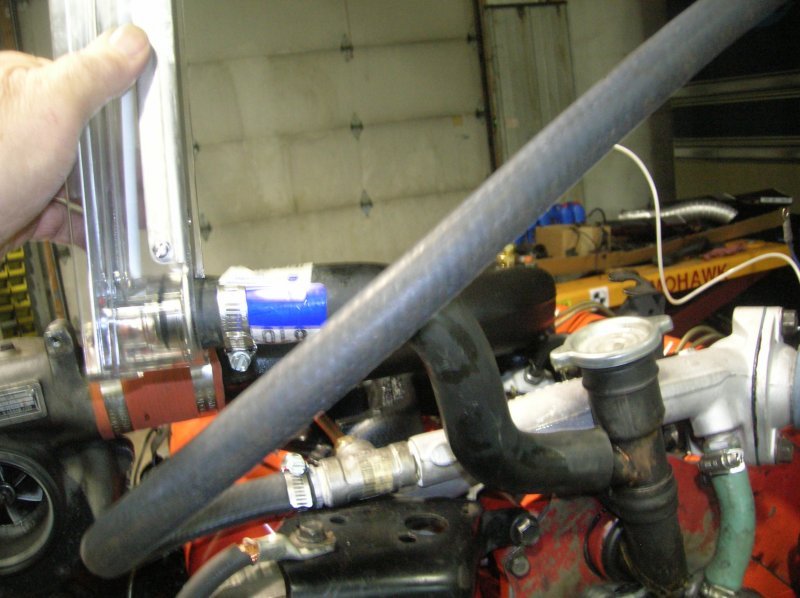

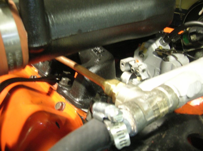

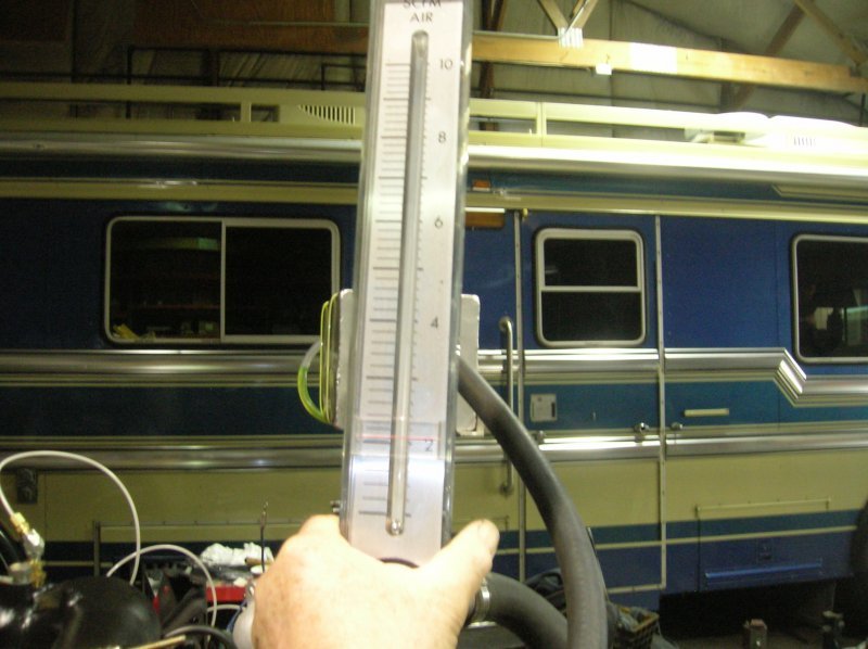

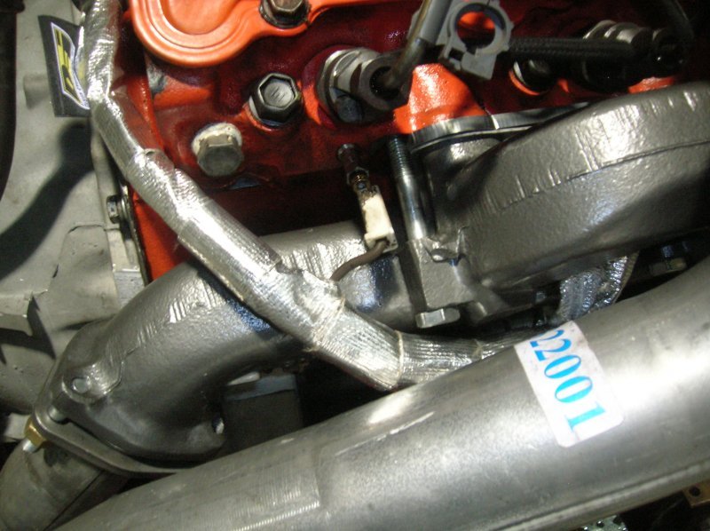

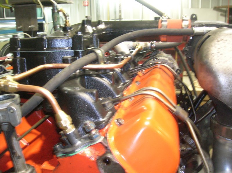

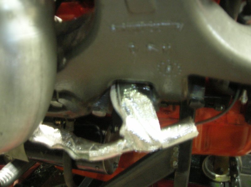

  1. After the epic fail of using 6.5 head gaskets on this 1st year 6.2, took my lumps installed correct +.010 Felpros w/yet another set of new head bolts. Hope I have the glow plug wires protected well enough, the vertical gage thing is to monitor blow by, reading were inconclusive. Crafted some copper tubing to equalize the water flow from back of block. Junk ran good once the air got out of there. With load, guessing about 1800 saw 5# of boost, WOT against the 13" Allison spec converter.
    Test stand continues to add value to my life, one of the load runs block heater blew out, easy fix on the stand, not so much in the 4x4 truck.

    Why did you have issues with 6.5 head gaskets? Its all we use, they are built better than the 6.2 gasket. I put 22 psi thru mine for a year, others also have also run more boost than me, no issues.
    Not sure I'd use the copper line, it will work harden and break, better to use pushlok hose or simple heater hose, my 2 cents. These engines vibrate, lol.

  9. I got a 1983 Wanderlodge that is fully plumbed with copper, air brake/chassis system, fuel system and house water system. Has 300k miles, nothing has cracked yet and life hasn't been kind to it. I know about vibration, chaffing, hoses rubbing thru, yes I do.
    The 82 6.2 heads have two little bean shaped passages bottom of the deck surface out side corners that aren't sealed by the 6.5 gasket, didn't know then, do now as I know what to look for. Found the info on another forum. Had to look hard @ the gaskets to see why. The Victor gaskets are the better choice in my view compared to the Felpros, however I did use the Fps due to the +.010 thickness.

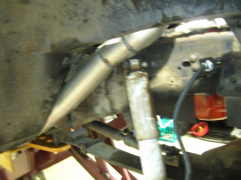

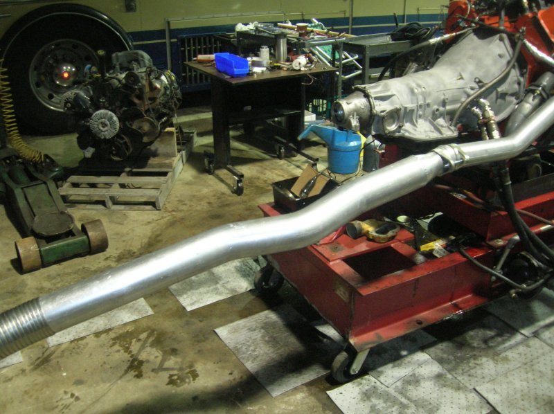

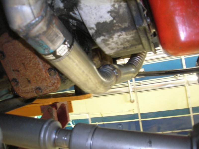

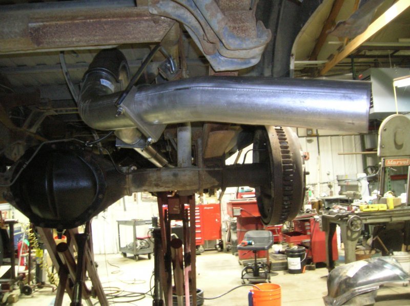

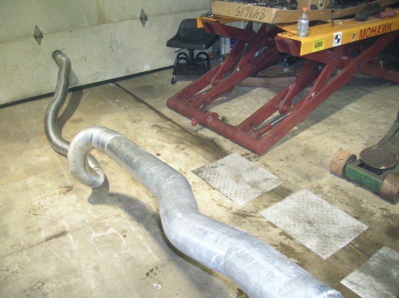

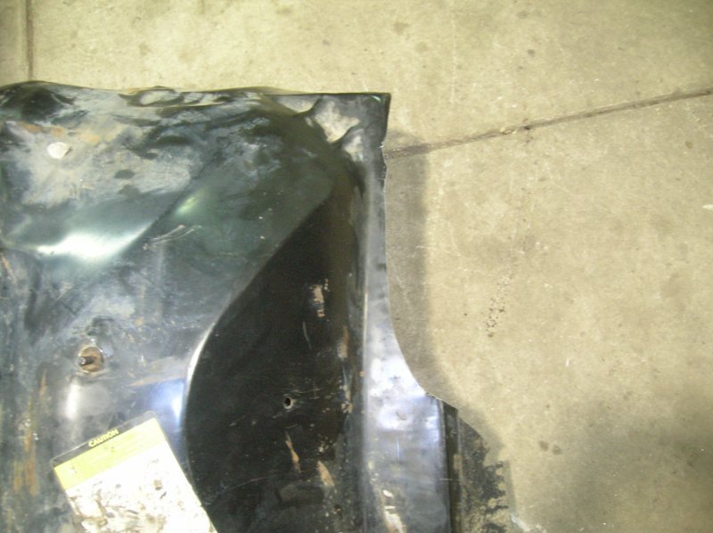

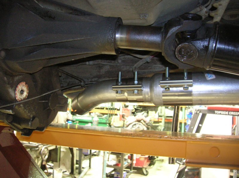

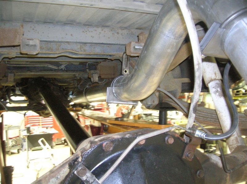

    Finally getting close to running the truck down the road. Exhaust system for a 88 and up, used most of the parts other than a few L's for the turbo down pipe, trimmed the inner fender a little and had to do a quick hack job on the cross over pipe to clear the front shaft.
    Was a loggers truck back in Idaho so the cab's a mess but new mat, freshen the dash, get the instruments working and fresh paint, it'll be a good old ride.

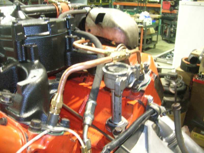

    Thought about it a while. As I'm a terrible person who doesn't give a damn if the planet likes me or not and pride my self by size of my carbon foot print, ran a 1" draft tube down below the frame rail from the oil spout. This rascal has a bit of blow by. It didn't leak a drop before the turbo install and as the engine only has 70k miles, figured leave sleeping dogs lie. Occurred to me that MAYBE the inlet air would provide enough draft to relieve the extra crank case pressure from the boost, so I cobbled a 1" barb to a short elbow @ the turbo inlet and clamped the K&N pos sort of filter to the front and made a 100 mile free way run, down to Badger diesel to pick up a fresh mechanical pump. No leaks, I'm so happy. However the rope seal is history, feel better if I replace with a new lip seal type. While @ Badger Diesel, Fred showed me a couple of pallets of 'stuff' from a Govt. auction, about 75 NEW AM General crank shafts in the original packaging. I took two, he'll have them on eBay.

    I noticed that too from your post, that you're venting the blowby externally thus releaving any crankcase pressure. All these engines have blow-by. The only ones that don't hardly have any where you can vent like this are those that are equipped with gapless 2nd compression rings. Even then, there is some, but much less than even a healthy stock engine. There is a good reason why the CDR system is designed the way it is, to create some vacuum to pull blow-by gasses into the combustion process.
    The normal way all of us 6.2 6.5 guys check our blow by is with a stock system running at operating temperature hot is to open the oil filler cap and observe smoke. If smoke is present there is more blow-by than the CDR system is capable of handling, more than average wear on the engine. Now take that same engine, and route the flow of blow-by away from the suction area (turbo inlet or intake on na engine) and you'll see a lot of blow by. So, venting yours openly you'll see a lot of blow-by smoke, it's not an indication that since your turbo'ed your engine that it's now got a lot more blow-by, it's that it's normal method of eating it's blow-by has been defeated.

  19. Might want to review post # 15. After 2000k highway miles @ 2500+ rpm, still dry down there and no oil consumption, engine is fine for my use. When it blows up, I'll build another.o_O
