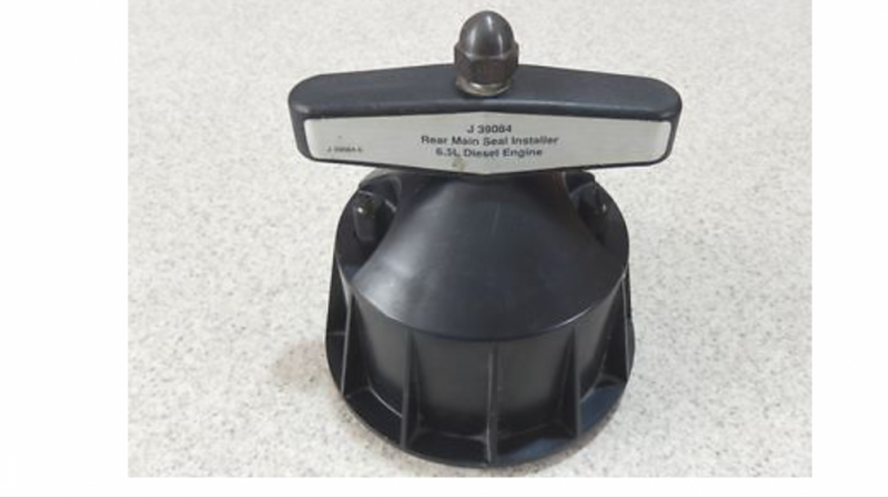

    I have never had to go beyond this, as the rest was a complete rebuild, I suspect a screw would have to be inserted into the seal so it could be pulled out. There is a special install tool recommended for the seal which I have never used either.

    Yep. And when the new seal is installed the depth is critical. There is a special install tool for it.
