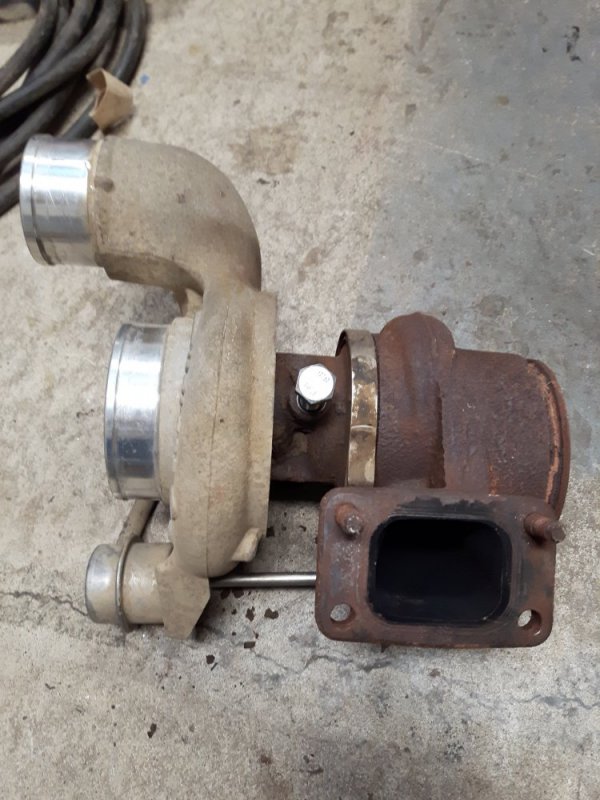

    I just picked this up (for Free!) And was considering it for my 6.5 TD.
    Im definitely foido a turbo update and likely a 4" exhaust in my Hummer. And a intercooler is coming into play.
    My question is - what is this turbo in relation to the HX 35 snd HX 40?
    I like free! Im opening it up tomorrow. EWha should I measure inside? Im new to turbos in detail. The outside of the intake is stamped 14mm.

    If it is stamped 14 on the inside of the turbine housing then it is a 14cm2 and far better than the stock HE351CW 9cm2 used on Ram Cummins @ 325 HP level or the GM8 9cm2, as other specs go search the part number and HE351.....general rule of thumb is that a very large CAC/IC is needed to cool down the air charge produced by any Holset turbo that has a 9cm2 turbine......

    I have a HE351VE to go on my next build, the blades are the same as a hx40... I have a stand alone controller to control the vanes in this one, I believe once I figure the controller out it will be a great fit..

    Nice to hear. Mine is the pressure pod actuated wastegate that is looped to the charge side. Ill see if it looks like I could vacuum actuate it. I have a DS4 and like how my Leroy Supertune controls boost.
    The variable vane is amazing. I've been watching them. There are a few stand alone controllers out there. The one I like the *least* you have you send back and pay for every adjustment you want.

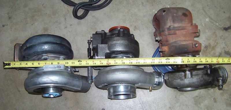

    Absolutely this is completely "out of the box". No wrong answers. Merely suggestions as to what can be done and what I have done.
    Offroad you may not want to rev it up all the time. Complexity vs. simple. The controller will have to be dunk proof for extreme offroading. Both methods are used today with constant velocity transmissions and complex turbo's that deliver power the entire engine RPM range.
    Again I encourage *someone* to make a H1 turbo kit.
    Personally I believe the entire RPM range of a 6.2 / 6.5 under 2000 RPM is wasted. Sure it's for economy and all, but, a 3/4 ton and H1 isn't exactly about economy. I have been disappointed in the RPM where the GM3 works in all but a unloaded DD configuration. Even then the gearing at freeway speeds generated a wasted 6 PSI of boost off engine airflow alone without the fuel on: May as well have a power robbing belt drive SC on the thing. The Spool Valve still didn't bring it to life like I had hoped. Getting the engine to a power band *now* is more fun.
    Here is high RPMs from a standstill with the Yank. Even with a 6.2 IP I feel it would out run a DS4 with a spool valve because *lag* waiting for the lower stall DS4 engine to get up to speed and light everything in it's power band. If I brake stand and punch it the engine jumps to 2000+ RPM and then there is a delay as the turbo lights off followed by the rear tires lighting off.

    The one sand is using may have a smaller hsw, the vgt's are a different animal, the he351ve weights a little over 40lbs, it's twice the size of the one he posted pics of, the vgt part & controller will provide anywhere from a 9cm to a 22cm size hsw.
    The blades however are the same, in essence I can make my turbine what ever size I need whenever I need to all by turning a knob on the controller, the controller uses 5 censors that allow it to be as oem would be ...
    Yes it's not a perfect turbo for every situation but me thinks it will be close for what I need...
