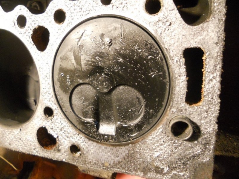

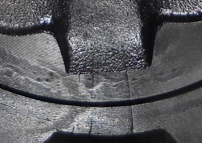

  17. WarWagon
    8,171
    2,544
    Nov 15, 2009
    Glow plug FOD damage as seen from the slightly higher than "scrap metal price" I paid for a parts engine. After the glows blew up I imagine the piston cracks on the passenger side are from "IDI destruction in a can" because there isn't any scuffing you get with overheating piston cracks. More carnage here: http://www.thetruckstop.us/forum/threads/1992-6-5td-rescue.44332/page-5
