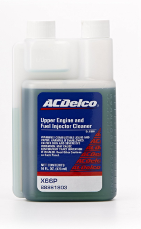

    upload_2018-1-12_17-21-31.png Is This the right cleaner or is there a specific one for diesel? Doesn't seem right but this is all a quick search turned up

  8. THEFERMANATOR
    THEFERMANATOR FRANKENBURBAN Staff Member Lead Moderator
    8,820
    2,023
    May 9, 2008
    ZEPHYRHILLS FL
    Thats the stuff. It WORKS! If anything will clean them without tear down, it will.

    I'm not having any sign of touble but I don't see how it could hurt. Maybe it'll help clear up my sticky turbo vanes a bit more. Changing to synthetic oil took care of most of the codes for those though.

    Got a jug on order. I won't put it in until I know I'm going to make a good run over 50 miles at 60 mph plus

    This is what I used on my LLY to clean it up after the bug issue was solved.
    :facepalm: WRONG ANSWER!!! :facepalm: Because one facepalm isn't enough.
    You run this stuff through the system from a 5 gal jug, pail, etc. :eek: DO NOT PUT IT IN THE TANK!!! You pour it into the 5 gal of diesel in a bucket and run that through the engine till it runs out of fuel in the 5 gal container. You disconnect the return and pickup lines from the tank to the bucket. You then change the fuel filter and hook the normal tank back up.
    If the tank needs service you drop it and clean it out separately.

    That stuff sounds similar to the liqui-moly diesel purge. (Vw crowd uses it)

    It would be smart to drain the fuel filter or ruin a new one. The Stuff has lots of alcohol in it to get water out of the system and IMO is the reason to only use it at idle. Let alone not getting a slug of water from the tank past the separator.
