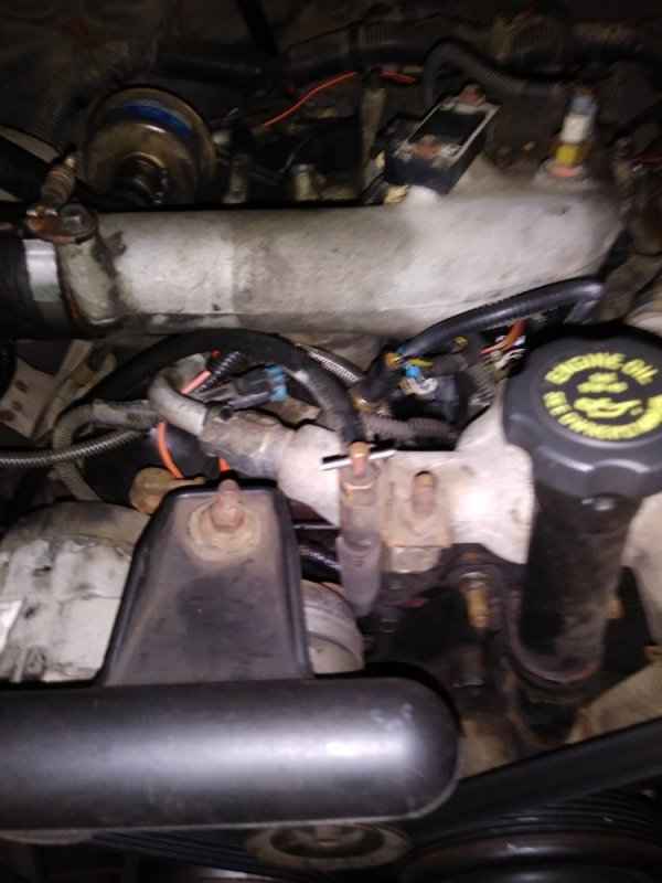

    Hi everyone, I'm new to this site. I have a 2000 chevy 3500 dump truck with a 6.5 td. I just had the injection pump replaced last week. Got the truck back Saturday afternoon, ran fine the rest of Saturday and Sunday. Then on Monday morning it wouldnt start. It cranks slower and louder than usual. I noticed what im pretty sure is a fuel line that wasn't connected. It comes off of the small t shaped thing in the front part of the engine on top. Also noticed a red spot in my driveway, got under truck and saw a different line that wasn't connected. Not sure if that is a drain line, both are about the same diameter. I can't afford to bring it to the shop right now. Please help, im not a mechanic but i can do some repairs.

    Is the one on top the fuel bleed valve? If they are lines the shop had off for changing the pump you aught to be able to get them to make it right....
    Have any pictures of the lines that aren't connected? If you can get some pictures that would be great to help identify...

    That valve with the T-handle on top is to drain water from the bottom of the filter.
    The other end of it is probably the hose You can see from under neath.
    Put a container under the open end of the hose, open that T valve, turn the ignition switch to run, there should be fuel run out of that hose for a few seconds, at least I think that is how it works.
    If you get no fuel then be checking the fuse to the lift pump.
    The lift pump relay can also be removed and jumped across, that should take the relay out of the equation if there is still no fuel spews out of the hose.
