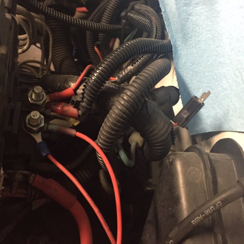

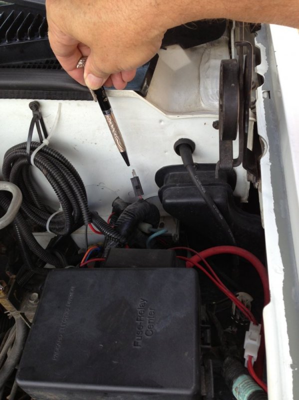

    Before buying a bunch of parts that may not solve the issue, do the jump test recommended above.
    Jump point for the Lift Pump.
    Use one of these two auxiliary power points behind the Underhood Fuse Box to jump power it.
