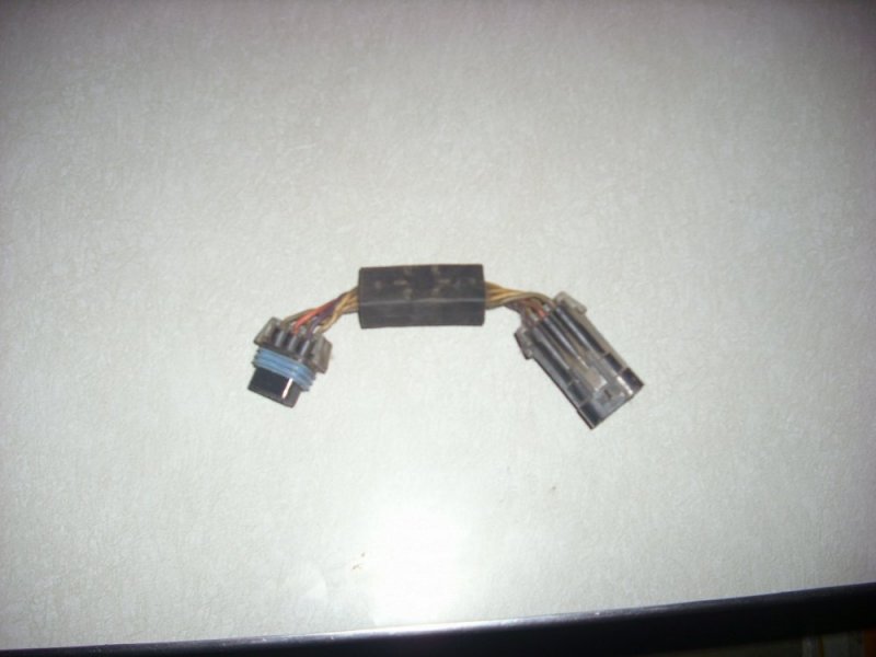

There's some sort of little electronic filter up by the injection pump that has been known to cause this symptom, too, but I can't recall what it is. Someone on here will know, for sure. I had this on my '95 and it didn't return after I replaced the part.
Thanks for that but as I wrote in The first post the OS filter is removed
