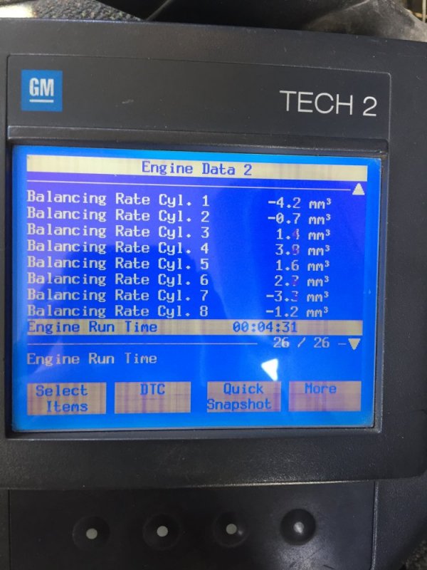

Thread starter #12
71E382CF-9155-4D91-A559-A867CEE52EAF.jpeg War wagon thanks for the reply!i haven’t been on in awhile. So my buddy owns a shop and he didn’t a quick scan with his tech 2. He didn’t have much time to actually look at it. And I read the ferms posts about balance rates and honestly it confused the shit out of me. I need to read it again when I have more time. I did replace #1 injector already and still knocks. So basically I did everything you just said before hand before I read this message. But, the knock is still there. Oil filter was clean no silver in the filter that was noticeable on the element and very very little residue on the filter mag. I did check the converter bolts and they were good. I’m not ruling out possibly a cracked flex plate but I’m leaning away from it cause the noise is from up front. I do have a bad driver side engine mount I’m most likely going to replace today. Have the parts already. Just had the trans serviced fluid was very dirty/grayish but not burnt. Probably going to need a trans soon :/ exhaust is 100% percent factorynand double checked not hitting anywhere. I did check the accessories thinking maybe water pump but the bearings felt smooth. The alternator is a little rough but the knock is coming from lower. There is a definitive knock at idle up through the rpm and then the turbo covers the sound of the knock. It seems to be coming from cyl #1 or #3. I was reading up on a possible cracked piston cause I do have some vapor coming from the fill cap but not an extreme amount. I know the engine produces windage so I’m taking that into consideration. It’s not enough to feel a puff or pressure against my palm. But I don’t have the symptoms of a cracked piston. Not a big enough crack that would cause that knock and certainly. Also I have No smoke no miss no check engine light. Runs just like normal perfect. Just and a personally irritating knock. And I have already done the ice pick for the connectors. I’m going to do a compression test Wednesday I think I should have time then. But I’m just stumped. I’m thinking I may have to take it into a shop :/ I keep trying to post videos of the knock and vapor but the site never lets me.
